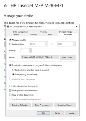

We see this often with Windows 11 and the most common cause is Windows replacing the HP driver with  Microsoft IPP driver. On your computer go to control panel then right click on the devices and printers icon and select open from the drop down menu. Next right click on the icon for your printer and select printer properties from the drop down menu. Click on the Advanced tab to see what driver is being used. If not the HP driver, click the down arrow next to the driver to display what other drivers are available and select the correct HP driver.

Hi, and thank you for the proposal. It looks like I use the HP driver or, at least, It's named similarly to the original. The problem appeared just two months ago. Previously ( And It's my second MFP 28-31) everything was as it supposed to be.

Next thing to check would be the type of port being used. From the screen you posted, click on the port tab. Printers often get configured with a WSD port if being network attached. I have never had good success with the WSD ports and suggest that you configure a standard TCP/IP port instead of a WSD.
