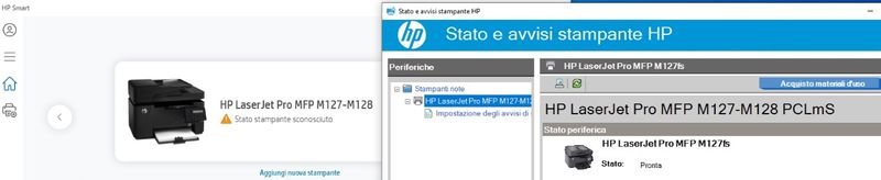

From about 2 weeks my printer refuse to print on Windows 10, i see that job goes in queue and exit from queue but printer do not respond to print, no errors showed on windows, no errors showed on printer.
Tried to complete remove drivers and hp smart software from computer, goes in device management and also remove hidden devices, reinstall all downloading latest setup from support website, also update printer firmware, reinstalled all and problem persist.
Also some other to notice: If i try to scan, i scan without problem all documents, so communication with printer seems good, i can see the percentage of toner from device information but HP Smart report printer status unknown.
If i goes to printer keyboard and ask to print a report printer print the report without any problem, if i insert a document in scanner and click on printer keyboard a copy i can obtain a copy without problem, so only communication with computer is the problem.
Last try: i connect the usb cable to another computer, an HP Laptop that already have installed HP Smart and have generic printer drivers, this computer have Windows 11 x64, also on this computer HP Smart report printer status unknown, but on this computer if i try to print document goes in queue that report printing and remain forever in this status also waiting like 10 minutes, no errors showed on both windows and printer, and also if i try to stop the print process the queue stucks trying to delete the queue but no errors also in this case the document remain in queue in deleting status.

Thanks for this guide, unfortunately nothing is changed, problem persist.
Just to clarify, problem occur during installation:
I force end installation and launch HP Smart:
Then i configure under HP Smart but still no response:
i currently does not try to configure in wi-fi or network mode, anyone think that is best to try ?
or other ideas ?
i really does not understand if my computer are playing with me or not:
