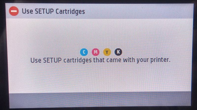

So we purchased a complete set of brand new genuine HP cartridges and began to perform the initial setup again.  Printer says NO!  "Use SETUP cartridges that came with your printer".  This was not possible because they were lost.

Location of back buttonLocation of back buttonError message during setupError message during setup
