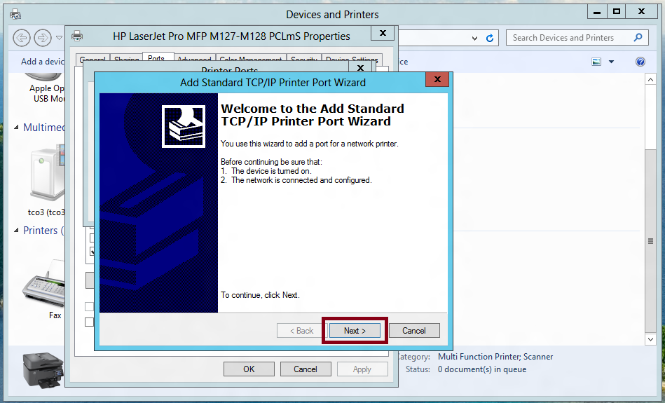

Try switching your printer port from using the WSD to a Standard TCP/IP port.
To do this, you will need your printer's current IP address.  The Network Configuration page shows the network settings for the product. To Print this page; Press the Network button () on the product control panel.
Next, you will want to do the following to switch the port:
1. Locate and open Devices and Printers.
2. Right click on your printer icon and choose Printer Properties.
3. Click on the Ports tab along the top of the page.
4. Click on the Add Port... button.
5. If you have the option for HP Standard TCP/IP Port, select it otherwise just select the Standard TCP/IP Port.
6. Click the New Port... button.
7. Click Next > button in the wizard.
8. Enter your printer's current IP address from your Network Configuration page. Note: The Port Name will auto-populate. I would recommend putting a check mark in the box; Always print to this device, even if it's IP address changes.
9. Click Next > button in the wizard.
10. Click the Finish button.
11. This may take you back to this Printer Ports window,
12. Select the port you configured and click Configure Port
13.Uncheck SNMP Status Enabled.
14. Then Click OK and Apply in the Properties Window.
15. Try it and see if this resolves this issue you are experiencing.
