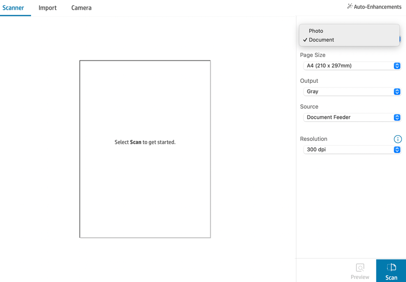

Well, there is hope...that's good. Alas, I can't see "presets menu". Where exactly is it located?
More step-by-step info will save time.
See two screenshots attached.
Screen Shot 2021-03-04 at 1.19.41 pm.pngScreen Shot 2021-03-04 at 1.20.03 pm.png

Thanks for bearing with me Shomlil.
When I launch the Smart app on my mac I don't see what you see. My first view is the screenshot I attached to the last post....there's no preset option.
Can you help me further or is there someone else you know who can? This might be a Mac difference??

OK, no I can finally see the picture you've shared so it is more clear now 😉
You may perform a such manually by using HP Easy Scan:
https://apps.apple.com/us/app/hp-easy-scan/id967004861?mt=12
From HP Easy Scan open the Presets menu and click on Edit Settings.
Set the Type as Document and the Source as the ADF (Automatic Document Feeder), then you may check the box below to manually scan both sides of the paper and press OK
Now follow the steps on screen, the application will prompt you to reload the other side and then complete the scan.
Shlomi
You should install and use HP Easy Scan app from the store, this cannot be done using the HP Smart app

Thank you soooo much for persevering with me.
