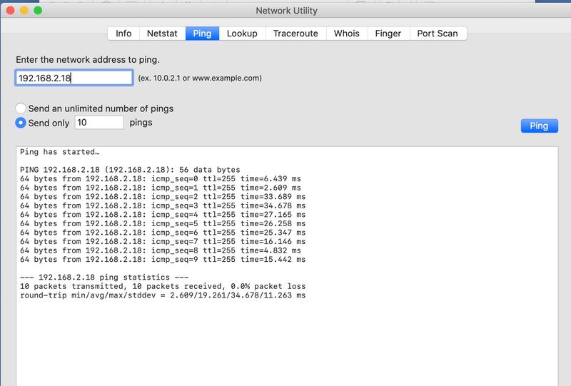

One day later to my earlier post. The printer is not connecting.  I'm including two ping tests, working (yesterday) and not working (today) and my printer report.
HP Printer Report 1HP Printer Report 1HP Printer 2HP Printer 2HP Printer 3HP Printer 3Yesterday PingYesterday PingToday Ping, Not WorkingToday Ping, Not WorkingYesterday Web Services, WorkingYesterday Web Services, WorkingToday Web Services, not workingToday Web Services, not working

One the ping test reports I see that there is a 100% packet loss which clearly is a sign of communication issue.
