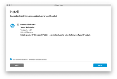

Download HP Easy Start and run through the setup process.  When it gets to the point for downloading the software it will inform you if yours is out of date.
If there is a newer version available it will automatically check the download box for you to install it.  Select Continue to install the new software.

It really looks like who are experiencing this issue are running older software signed with a certificate that expired today.
Please update your software using HP Easy Start as mentioned above.
1. Download HP Easy Start
2. Follow the prompts for setting up your printer.  When you get to the software download it will show whether the software needs updated or not.  If it does the box next to Printer Essentials will be checked by default and you just need to select the Install button.
The following should not be necessary but if you want to be extra diligent and guarantee a clean new install.
2. Open HP Easy Start and Select the HP Easy Start Menu in the macOS menu bar.  In this menu select Uninstall HP Software.
3.Select Continue to start the Uninstall process
4. Once the uninstall completes.  Select Set Up New Device.
5. Go through the new device setup process by following the prompts.
6. This will lead to the software download/install prompt.
7. Select install and the remaining prompts to finish the process.
