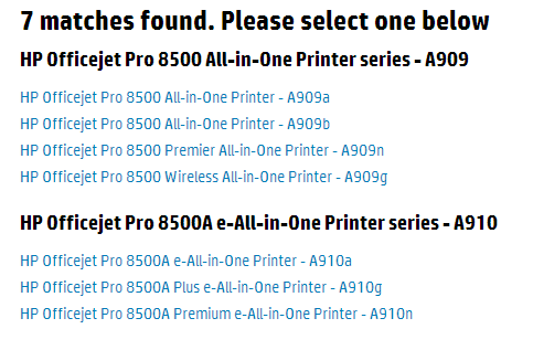

  3. What is the exact model name of your printer (for example, the Officejet 8500 has a few of those in its series).  See image below and let me know which model of printer you have because steps may differ.
Answer those questions for me please and I will do my best to assist you.

My printer is an Officejet Pro 8500A, A910a (Product #CM755A).  At first I was having intermittent printing problems, with  the printheads cleaning after the printing of only 5-6 pages, then it would print only in black,not in color.  Eventually it became stuck in the continuous loop of "checking the printer, this may take a few minutes" to "cleaning the printheads" on a constant basis, drinking up tanks of expensive ink in the process.  The hard reset did not work.  My printer cord is plugged into a surge protector, along with all of the other computer cords.  This printer is only a little over two years old, but I am ready to trash it.  My previous HP is 12 years old & still works!
