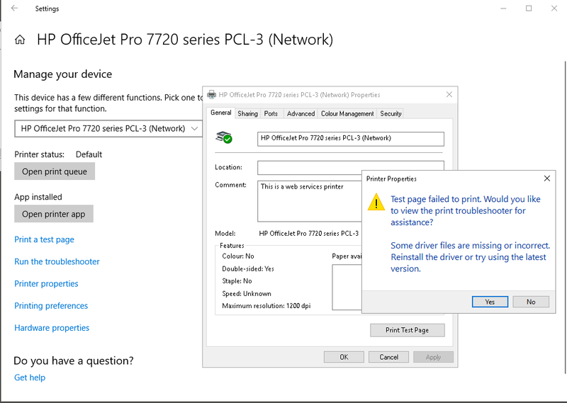

I have recently bought an OfficeJet 7720 Pro but I cannot get it to install on my Windows 10 desktop.
I've downloaded the driver via 123.hp.com/ojp7720 and run through the install process to the end and everything looks like it has worked but if I try and print a Windows test page I get the following error...
Operation could not be completed (error 0x00000570)
Some driver files are missing or incorrect. Reinstall the driver or try using the latest version
I've tried forcefully uninstalling everything, including deleting the entries in the registry and the drivers from the System32/spool director then re-installing but I get the same problem.
I have managed to install the printer on my Windows 10 laptop and successfully printed from that but I can't get the same printer working on my desktop which is the main family PC.

I finally had some time to look at this issue again. I've followed all of your steps and still not got the printer working from my desktop PC.
I'm connecting wirelessly (although I did also try USB). I've even tried disabling the firewall on my PC to see if that was the problem but that made no difference either. I've also run the HP Print and Scan Doctor but that's unable to resolve the problem (its not able to scan either by the way).

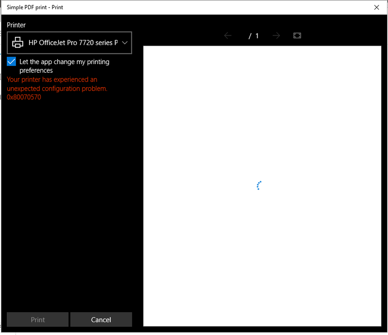

Hi
Unfortunately HP Smart will not print. If I try to print through HP Smart i get the error...
Your printer has experienced an unexpected configuration problem. 0x80070570

Hi
Thanks for the further advice. That registry folder already had full control permissions for both the administrators group and myself but I did delete the registry keys that you listed. Once I had done that I reset the default printer and then tried to print a test page from the Printer Properties dialog. This is what I see when I do that..
...and I see this (the same error) when I try and print from HP Smart...

Hi
Still no luck
As before the PRINTERS folder was already empty when I started and when I open the printer properties dialog it tells me that the printer drivers are missing (no **bleep**).
I re-installed the full driver set (again) and I added a port (I'd prevoiusly tried that but did it again anyway) but I still get told that the drivers are missing when I try and print.
Surely there must be some way to verify if the drivers are, in fact, installed and to ensure that they do install when I run the installation routine.
