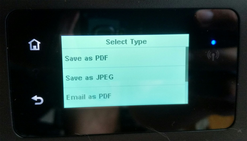

I bought a HP Officejet 5220 last weekend.
Problem is that I am unable to scan documents consisting of multiple pages in one PDF.
Every time the scanner asks me if I want to scan "another Item", I touch "add item".
And every time after a few seconds the screen shown in step 4 appears and interupts the scan process. This happens much faster than I can swap the papers to scan. I tried it multiple times already.

I'm trying to scan two sided documents, which is why I'm using the scanner glass.
The software seems like a nice option but I'd really like to to multiple side scans from the printer/scanner instead of switching between PC and scanner/printer for every single side. Since the interface is asking me if I want to continue with a next page that certainly should be possible?
I actually bought this scanner/printer to replace a 7 year old Canon device that could manage this task with ease.

Thank you!
The installer shows the current printer's firmware as "up to date" and therefore doesn't let me install the firmware update.
Seems like the problem is not solved with the September issue of the firmware.

The driver is installed and I was using an administrator account.
Not sure how your reply it related to my problem at hand though?
We are talking about an issue with the firmware here - not the drivers on the PC.
