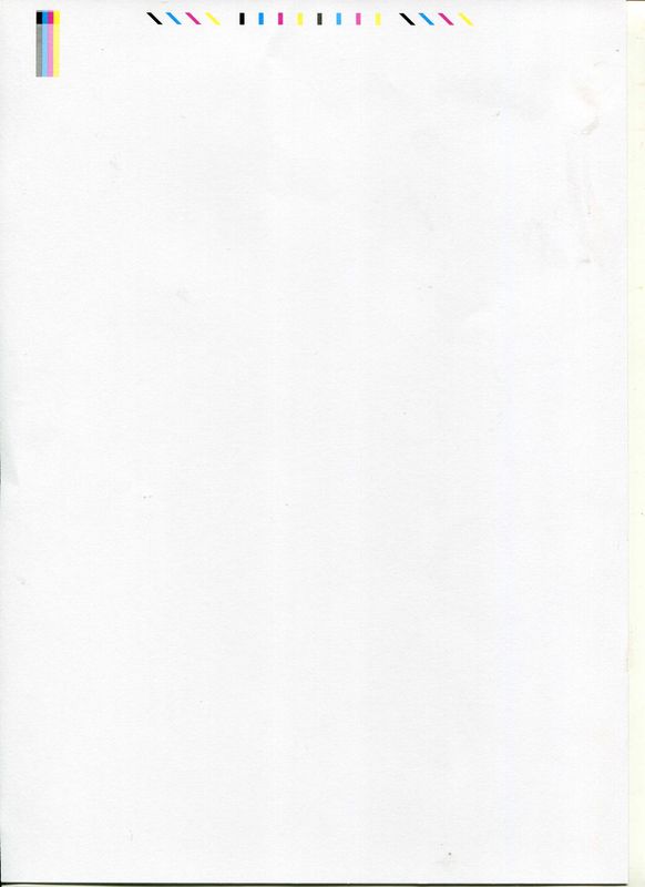

Shlomi, thanks for the quick response. It appears to be part of a colour test page. Just at the top of the page there is a vertical column about 22 mm high KCMY, then four coloured dashes \\\\ eight |||| |||| four \\\\ each group KCMY

Thanks, first the extra page appears after a print out, not before. I have tried "Align printheads"  but there is no change. Also the page printed is just the top row, not as shown below.

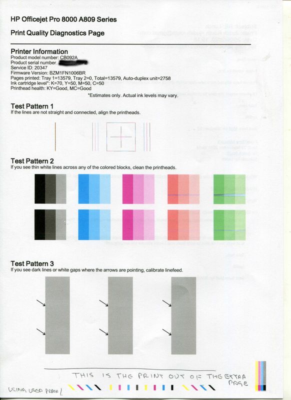

Could you please add a screenshot of the printed report to verify? i would guess this due the same cause due to any cartridge or printhead issue.
Also, please print and include a Print Quality Report, see Step Four below:
https://support.hp.com/in-en/document/c01962224

Sorry, not sure what "screenshot of the printed report to verify" means. I attach a copy of the Diagnostics page. Printed on used paperHP Officejet Pro001.jpg

Here is the diagnostic print-out and a print-out of the extra page that is printed AFTER each print job.Had a little difficulty doing this!
Tony
DiagnosticDiagnosticpage that follows a print-outpage that follows a print-out
