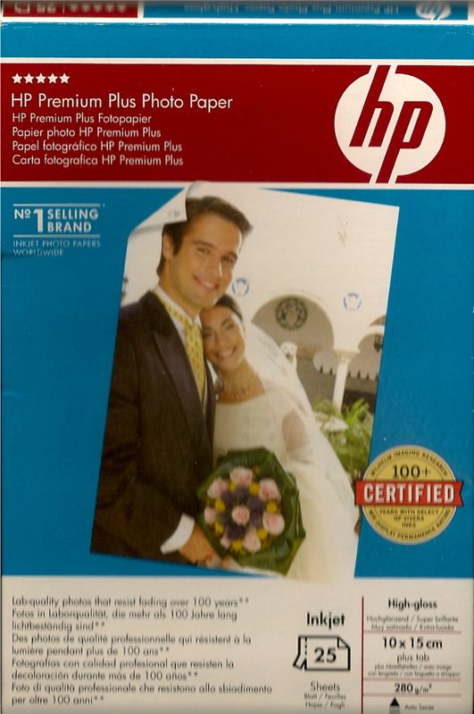

Well, I perused the options for support and end up on this forum again.  When the warranty of a product has expired, the choices for support become very limited, or only at a cost that will justify the purchase of a new device.
As I still have problems with photo printing – in a very rare moment a photo does get printed – I have been trying to buy HP photo paper WITH TAB.  But that proves to be a challenge.
My local dealer did not carry HP photo paper WITH TAB, but of course did WITHOUT TAB.  I tried several web shops, but none of them have it or even have not heard from it.
The C7280 came with a pack of 25 high gloss HP Premium Plus Photo Paper 10x15cm 280g/m2 WITH TAB and states product code Q8027A.  For sure, that HP product no longer exists and has been replaced by something else, presumably, but unknown to dealers, web shops and me.
I have the feeling that 10x15cm photo paper WITH TAB would not give paper jam or whatever, and print the photo correctly.  Because of the extra length – approx. 1cm – the paper transport mechanism in the back would be able to move the photo paper WITH TAB without a problem, and not cause slipping or the like.
Currently, the paper jam and carriage jam (a fault that showed up later) no longer occur, for whatever reason.  It could be that the jam messages were erroneously displayed or that a shutdown and restart of the C7280 reset or corrected the firmware.HP photo paper_01.jpgHP photo paper_02.jpg
