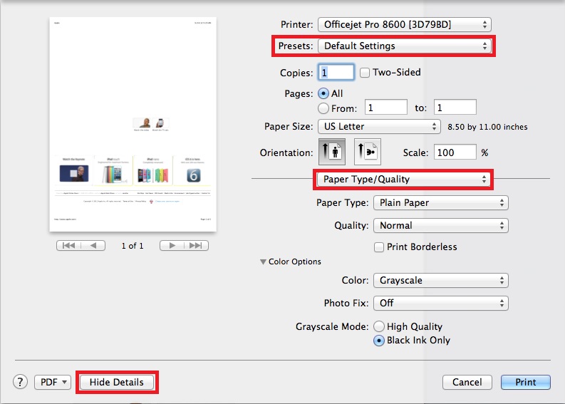

To create a preset using TextEdit:
  1. Open TextEdit from the Application folder
  2. Click File>Print
  3. In the print window click on show details at the bottom
  4. Select the TextEdit dropdown and click on Paper type and quality
  5. In paper type and quality you should be able to set your custom paper size and type
  6. Once the preset is created you will want to save and name it
  7. Click on the preset dropdown and click on save settings as current preset
  8. Name the preset, confirm  and close the page
  9. Open your Word document and choose your new preset and see if it works for you! 🙂
Please post back and let me know how everything goes!

Cbert,
I tried your suggested solution and it did not work.  Here are the steps that I took:
1.  I created a document as you suggested using TextEdit and proceded to the print function.
I opened the Textedit v1.10(319) File>Print diolog box and much to my surprise, there was no  Paper type and quality
selection to choose. The closest thing I could find was the  Media & Quality selection which has no ability to create a paper size preset.
2.  I next selected File>Page Setup hoping this might work.  In Page setup, I went to the Papersize dialog box and used the Manage Custom  Sizes dropdown to create a custom paper size and applied this to the TextEdit document.  Incidentaly, the custom size that I created in Word was displayed  as a choice in the custom names box of the dialog box.  Feeling confident I selected File>Print and sent the TextEdit document to the printer and guess what. The printer gave me a Paper Mismach - The paper size detected by the printer sensor does not match the paper size selected in software. Undeterred, I proceeded back to Word to see what I would find.  I redefined the paper size to the same one that I had created in TextEdit and attemted to print The result was the same: Paper Mismatch.
My only Question now is What's next?
