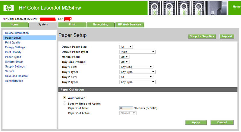

I was able to solve the problem on HP Color LaserJet M254nw and iPhone 8 (iOS 11.2.6). I have changed the paper type in both trays to A4 (System-Paper Setup-Tray size). And now when sending to print Iphone writes the size of A4 paper. And then prints in full size. Below I attach screenshots.Screenshot_1.png
