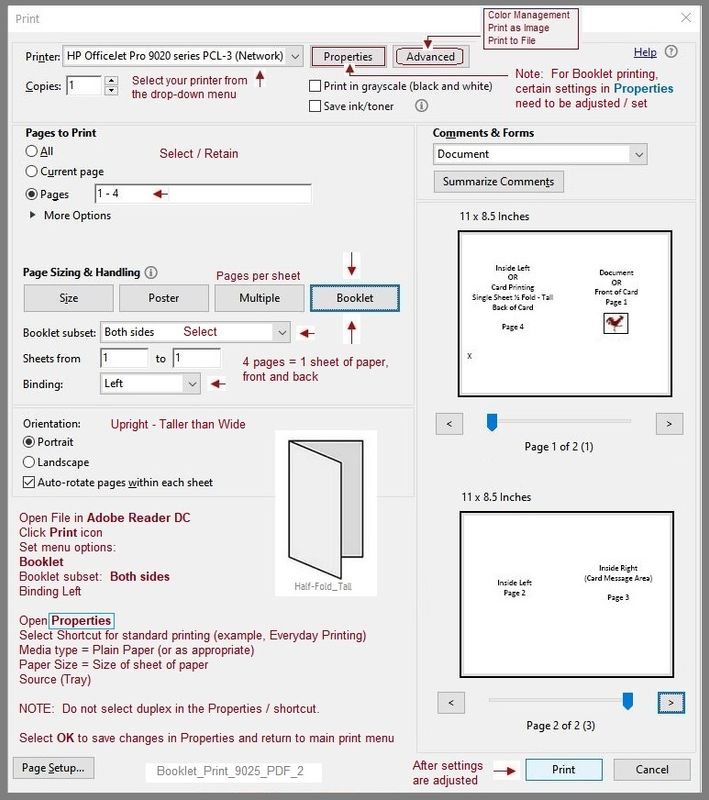

Example - Card 1/2 fold - Word Document
Word_Booklet_Print_2Word_Booklet_Print_2
What else?
If you are printing your template directly from Word,
Export the document to PDF and print from Adobe Reader DC
Example - Adobe Reader DC  - Card Print - 1/2 Card Fold
Booklet_Print_9025_PDF_2Booklet_Print_9025_PDF_2
