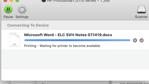

Hey Bryan:  I followed your instructions and suggestions.  I reloaded the software as you suggested and it got the printer to stop giving an error message.  However, now it just says "waiting for printer to become available."  I checked the connectivity and the printer shows it is online, etc...   Suggestions?
