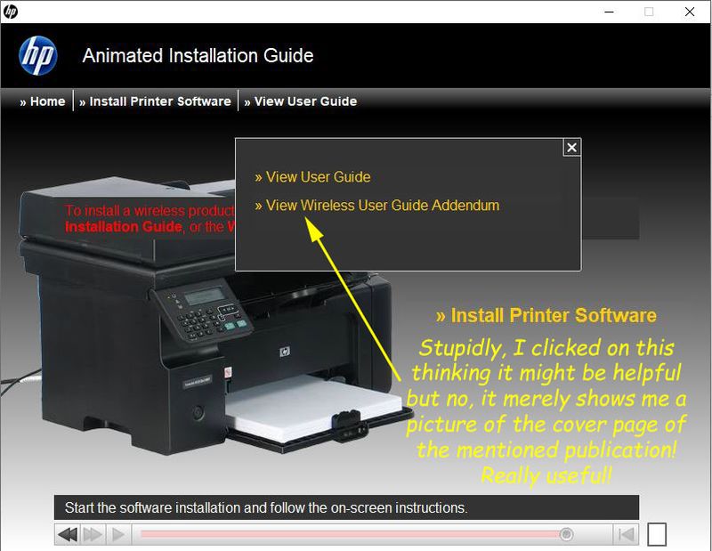

I have resorted to following this manual which suggested attaching by USB, that has downloaded and installed drivers but at the end, every link in the so called "Help Navigation" takes me to the end of the internet!

I did however solve the above problem, the window which appeared upon clicking the "View Wireless User Guide Addendum" was so small that the content pane was totally out of view, enlarging it revealed the full content and navigability!
