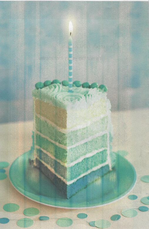

When printing an image I am getting vertical lines from top to bottom spaced about a half inch apart.  This occurs both from my desktop computer which is direct wired and from any wireless device. I have all new ink cartridges. This problem started prior to the new ink being installed. The print test page looks perfect. I tried running the cleaning tools in the printer software but it made no difference. What am I missing?Actual printed imageActual printed image

Thank you for your response Flower_Bud. I only get the vertical lines while printing pictures. Images are lines and streaky on all applications. Images are also streaky when copying (photocopy). The last time my printer worked properly was about 4 months ago.

Step 14: I printed another Print Quality Diagnostics Page and it looks the same as the previous one.
Prior to this issue with printing pictures, I was very satisfied with this printer. It printed supberb pictures. Any other ideas are welcome. I may be still able to have this repaired or replaced under warranty. I will check on my purchase date.

It took a little bit but I finally received a solution to my issue. Apparently there was no user fix . Thanks to "Flower_Bud" and "JeffHelp" who are support agents for HP my issue was forwarded to Jerry at HP. Jerry offered a solution of replacing my printer with a Certified Refurbished printer. I gladly accepted the offer and had my replacement in a few days.
I am now happy to report that my images are back to being perfect! Thanks to the HP Support Forum I was put in touch with the right person. What an awesome company HP is. They definately stand behind their product 100% even if the warranty is expired. I am a lifetime customer!
