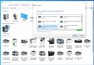

Someone probably has this documented with screen shots, you can probably google "add printer win 10 control panel" and find a decent guide.
Start by opening the control panel in windows 10. Type "control panel" in your search bar.
Then choose "View Devices and Printers" under hardware and sound. Click "Add a printer" Wiindows 10 should detect your printer for you. If it does not, you may have to manually add the printer.
At this point, Windows 10 should have installed a working print driver. If it does not work, you can change the driver by right clicking on the printer icon and selecting "Printer properties" You find the driver under the "Advanced" tab
This is what I'm talking about with the "Windows Update" The add printer wizard will download current working drivers, and you can change the printer driver type to the various HP drivers that download this way. It will take it a few minuets to complete.
Select "HP" on the left and scroll all the way to the bottom on the right and try the "HP Universal Printing PCL6" driver.
WSD ports are a technicians worst nightmare. How are you connecting this printer to your PC? If you're using wireless or a wired network connection, that uses TCP/IP protocol and you printer will have an IP address (something like 192.168.1.69)
If you're connecting with a USB cable, then your PC is using a local USB port (USB001). Windows 10 can change your TCP/IP port to a WSD port. Sometimes they work, and sometime they do not. You may have to add a TCP/IP port back to the print driver. A WSD port is basically a failed attempt by Microsoft to have Windows 10 treat a network device like a plug and play device. It has been a problem that's been around for years and has always been broken.
