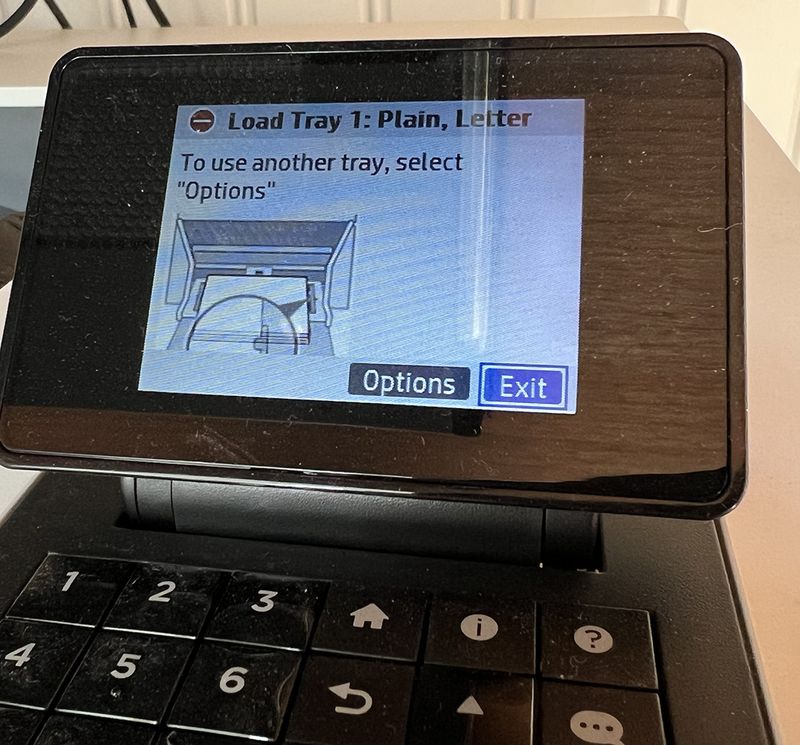

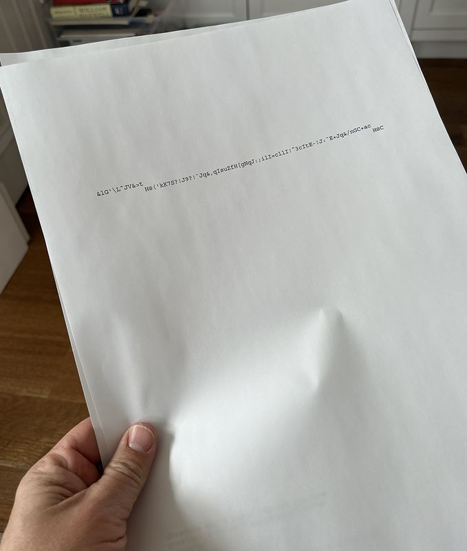

This is absolute madness. I've updated all the software and firmware, and still no resolution. Plus, now, this:
• It continues to report an "error receiving data" ANY time you change print settings, or print from a different app;
• It regularly demands letter size paper in tray 1, even though I ONLY use tabloid size paper and have it loaded in tray 2, and have configured this correctly in both the Print and Print Setup dialog boxes;

• Clicking "print" from the printer itself produces pages of gibberish, burning through my paper supply.

EVERY time I print, it asks for letter size paper, even though…EVERY time I print, it asks for letter size paper, even though……the dialog box is clearly set up correctly, specifying the correctly loaded paper size in the correctly loaded tray.…the dialog box is clearly set up correctly, specifying the correctly loaded paper size in the correctly loaded tray.A good number of my jobs come out like this.A good number of my jobs come out like this.
Couple of things come to mind:
1. Are you using an HP supplied driver or a generic Apple PS driver?  I ask because the sheet of random letters is often the sign of a wrong driver being used and the print is the result of the printer not understanding a print command
2. In terms of the insert letter paper in tray 1. The printer reacts to the print job that is sent. If it sees a command stating that the job is to be printed on letter and it has no letter it will ask. It only does what it is asked to do. In your case this even more so suggests that there is some sort of driver issue such as corruption or wrong driver.
If you find the information provided useful or solves your problems, help other users find the solution easier by marking my post as an accepted solution. Clicking "yes" on "was this reply helpful" also increases the chances that this solution will help others.
I am a volunteer, offering my knowledge to support fellow users, I do not work for HP nor speak for HP.
Thanks, Repairatrooper. I also thought it might be a driver issue, but it doesn't look like it is. To answer your questions,
  1. I am using the HP-supplied driver, version 19.3601.
  2. The jobs that I send always specify "tabloid" (or "11x17", depending on the application.)
Is anyone from HP listening?
