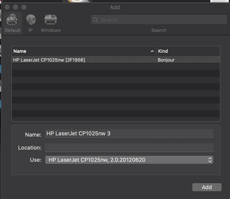

Make sure the printer is installed using AirPrint driver:
1.) Click the Apple menu, click System Preferences, and then click Print & Scan or Printers & Scanners.
2.) Check if your printer name displays in the Printers list, If your printer is listed, click the printer name, click the minus sign to delete the printer.
3.) If you see multiple printer queues for the same printer, remove all extra printers by selecting them one at a time, and then clicking the minus button at the bottom of the list.
4.) Click the plus sign, click Add Printer or Scanner, click the printer name with Bonjour multifunction under kind.
5.) Click the Use or Print Using menu, select AirPrint in the pop-up menu. Then click Add.
6.) Try to print.

I tried below step. When i was trying to install driver it say's
Driver downloaded from
When i try to add printer it Does not shows Air print or Bonjour multifunction under kind.
Even for Windows it just works with USB print and not wireless .

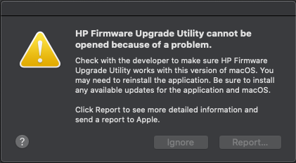

Hi @KUMAR0307
Please find below crash info / failed information while applying the firmware , When HP can provide driver for the same ? The MacOS is 10.15 is 64 bit which can not accep
@DIPT wrote:HI @KUMAR0307,
Thanks for help. As per Apple Support these printer is not listed for Airprint capability.
https://support.apple.com/en-us/HT201311
And as indicated earlier HP Website does not have Firmware for 10.15 OS. Can HP Provides same ?
Process: HP Firmware Upgrade Utility [24759]
Path: /private/var/folders/*/HP Firmware Upgrade Utility.app/Contents/MacOS/HP Firmware Upgrade Utility
Identifier: com.yourcompany.HP_Firmware_Upgrade_Utility
Version: 3.3
Code Type: X86-64 (Native)
Parent Process: ??? [1]
Responsible: HP Firmware Upgrade Utility [24759]
User ID: 501
Date/Time: 2020-04-16 20:49:27.224 -0600
OS Version: Mac OS X 10.15.4 (19E266)
Report Version: 12
Bridge OS Version: 3.0 (14Y908)
Anonymous UUID: 278002A3-57F7-4721-194D-8184A1B1CFDC
Sleep/Wake UUID: 8F5B1576-2A96-4424-AC1B-95C010EFBAE0
Time Awake Since Boot: 65000 seconds
Time Since Wake: 1700 seconds
System Integrity Protection: enabled
Notes: Translocated Process
Crashed Thread: 0
Exception Type: EXC_CRASH (SIGABRT)
Exception Codes: 0x0000000000000000, 0x0000000000000000
Exception Note: EXC_CORPSE_NOTIFY
Termination Reason: DYLD, [0x1] Library missing
Application Specific Information:
dyld: launch, loading dependent libraries
Dyld Error Message:
Library not loaded: /usr/lib/libnetsnmp.15.dylib
Referenced from: /private/var/folders/*/HP Firmware Upgrade Utility.app/Contents/MacOS/HP Firmware Upgrade Utility
Reason: image not found
