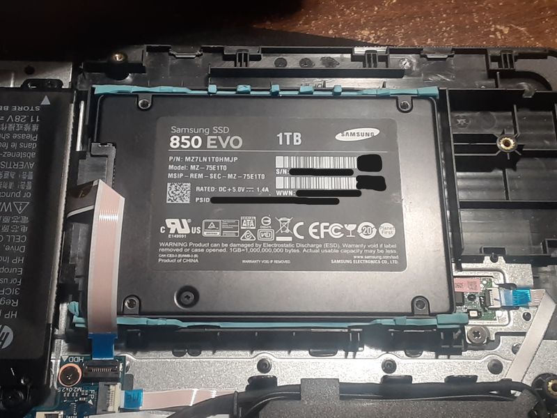

I tested each cable for pinouts with a meter against the SATA spec for the drive side. I wanted some assurance there was some year over year consistency before maybe I actually stuck a drive in. I also was not about to try to use probes on the ZIF on a live laptop.  What I learned I think might help a few others.
The list of known good cables (by me) for HP cp100, cp000, cn000:
PickedCable modelLaptop serieseBay item I ordered
*L23889-00115-cs, 15-cw, 15t-cs, 15z-cs, etc...https://www.ebay.com/itm/284251101364near same lenght and folds work as is
 L22534-00117-by, 17-ca, 17q-cr, 17z-ca, 17t-by, etc...https://www.ebay.com/itm/224994774300longer than neccessary, would still work
 M75893-00117-cp, 17-cn, 17z-cp, etc...
The 17-j / 15-j series will probably also work fine, but are missing the 3.3v NC pin, which has no connection to the cable or motherboard, but may be used to trick certain odd drives. No 2.5 inch drives that I know of have a connection to any 3.3v pin. It's easy to see by looking at the drive and the traces and how those pins arnt even connected to the boards. 2.5 inch boards are just void of 12v and 3.3v. MSATA that uses only 3.3v, and 2.5 inch SATA uses only 5v.
I chose the cm-15 cable because it was nearly the same length and the fold was already in the right place.

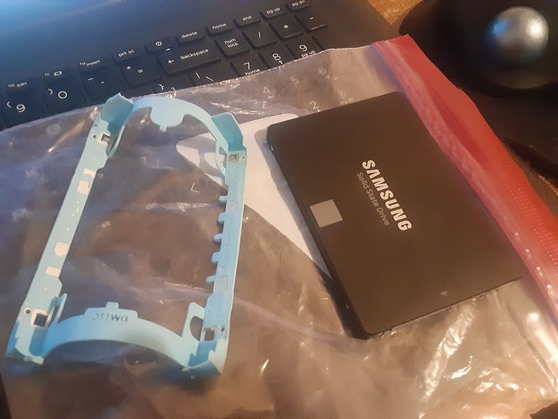

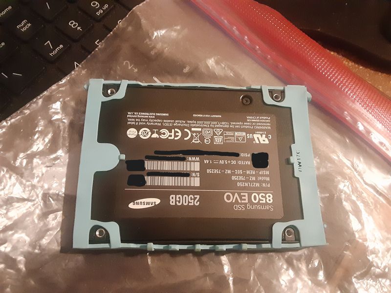

I used an old 17-j/15-j series drive blue caddy, the thin blue rubber kind, trimmed to mechanically fit the same. I Attempted using the 17-by and 15-cm caddies, but there were various issues.  The BY was too fat, the rails weren't skinny enough, and the cm was just one side.  The DV style caddies are just thin enough to fit. Is a very nice fit around the edges.
If you watch the HP 17 cn/cp000 disassembly video, and some of the others, you can see the drive itself is supposed to be nearly flush with its mount hole sides, and the black nubs stick up a bit, and there is no material between the drive and the cable. Its important to consider so that the case comes back together correctly and the cable have no real pressure on it from the case.

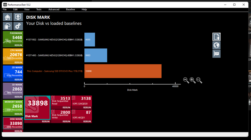

So, here are the PassMark numbers:
The previous two are my tests from last night before upgrades on the stock OBE Win 11 (out of the box stock windows 11), run with HP default power profile, and stock Balanced profile, itself set to balanced. The current test today is clean Win 11 with the new parts described above, on stock Win 11 Balanced power profile, itself set to high.  None of these tests were using APC TDP changer utility, this is stock TDP. I tried a few attempts, but it made it worse by a lot. I think these retuned xx25 processors are riding their own max temp with some new magic and I wouldn't bother. The CP/CNs are a single fan single pipe setup, and I'm getting numbers near-ish of the ProBook 14s, so I'm not going to bother. The juice is very good, and I'm not going to squeeze anymore.
Edit 5/30/2022:
I'd like to amend what I said before about the TDP. After finally checking, this model is already set for sustained 25W by HP.   I thought maybe it was some kind of boost during the test, but its already tuned 25W automatically.
Today I tried HWMonitor, and kept a load on it using the Pass Mark home screen, and with a 1080p YouTube music video playing behind it, and it sat at 25w dead on for minutes and stayed maybe 77c the whole time.  The site says 15W so maybe it means the normal stated marketing TDP for the Ryzen U series. But it will for sure automatically go 25w under sustained load. On the cp100 at least there is no bios option to turn on or off, so it's just this way all the time. The Cooler looks like it can take it just fine.  I'd also like to point out that this was using Windows 11 clean install default Balance power profile, left itself at balance.  So... this laptop is the real deal.
That one above shows 25w on package balancing GPU 3D render, 1080p video, and CPU.
This one shows CPU load at 25w, because I realized I hadn't seen the CPU only, yet so I went to check. And yep that works too. Max temp was 81.1.  I might try prime later, which is only CPU. This one is mixed memory and CPU. The 7z settings were 8 Core and 24GB used for compression over 10GB of mixed data.
 Second test with all 16 threads was doing about 32MB/s. 256MB dictionary size, 23GB memory used for compression.
The rest below was my original post from the 27th.
-- End edit --
1) HP OBE Win 11 stock, with stock parts, with stock Balanced profile, which I switched to, to test
2) HP OBE Win 11 stock, with stock parts, with stock HP power profile, that it originally started up with
3) Clean Win 11 stock, with new parts, with stock Balanced profile set to high
Link to the last baseline, my current setup, is here:
PassMark Software - Display Baseline ID# 1572341
Passmark OverallPassmark Overall
Passmark CPUPassmark CPU
Passmark GPUPassmark GPU
Passmark MEMPassmark MEM
Passmark MEM WritePassmark MEM Write
Passmark DiskPassmark Disk
I'd argue that this is probably the best performance, with or without my upgrades, of any budget to mid model out there by anyone at the moment, esp. if you want a 17 inch where pickings are slim, very cleverly disguised as the lowest one they offer. Good job HP.
