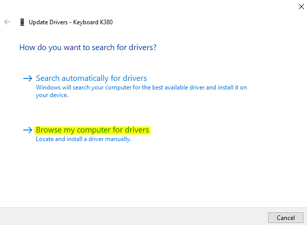

finally it worked, but I couldn't get rid of the "wrong" driver using the standard (and only) procedure, though I just tried to install a new one, look:
1) I try to update the driver, I right click on the device, then Update driver.
2) when I am in the window where the system asks if I want to search automatically for drivers or I want to browse my computer for drivers, I choose the second option:
3) Then I choose "Let me pick from a list...":
4) Then I see a window where I can choose the Generic driver that you said.
5) I choose that driver and reboot my machine.
6) Once it's up and running, following the same process I install the driver you sent me.
And boom! it worked 🙂
