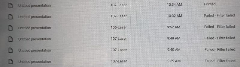

@KUMAR0307, are 100% sure about your response "Filter failed errors are found on Macs, not on Chromebooks. Kindly recheck the error."?
This is a screenshot from one of our Chromebooks with the issue:
For the OP:
If you run across this issue in the future, try checking off the "Print as Image" box. It worked for us, but we are unsure how and why. We're assuming it has something to do with memory in either/and printer and chromebook.
Thanks for the info, I’ll give it a try when the issue arises again and post an update.
Great tip, checking the print as image box allowed me to print the pdf.
