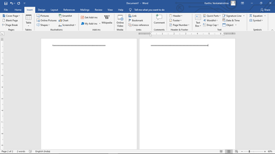

When i try duplex printing, the 1st side prints as is shown on the PC screen, but the 2nd side alignment is altered. It prints 1-2 lines below the actual alignment on screen. how do i correct this? Right-left alignment and alignment on i sided printing is fine.
alignment on laptop
alignment on laptopalignment on laptop
1st side printed as per alignment on laptop
1st side1st side
2nd side print starts at a lower level
2nd side2nd side
