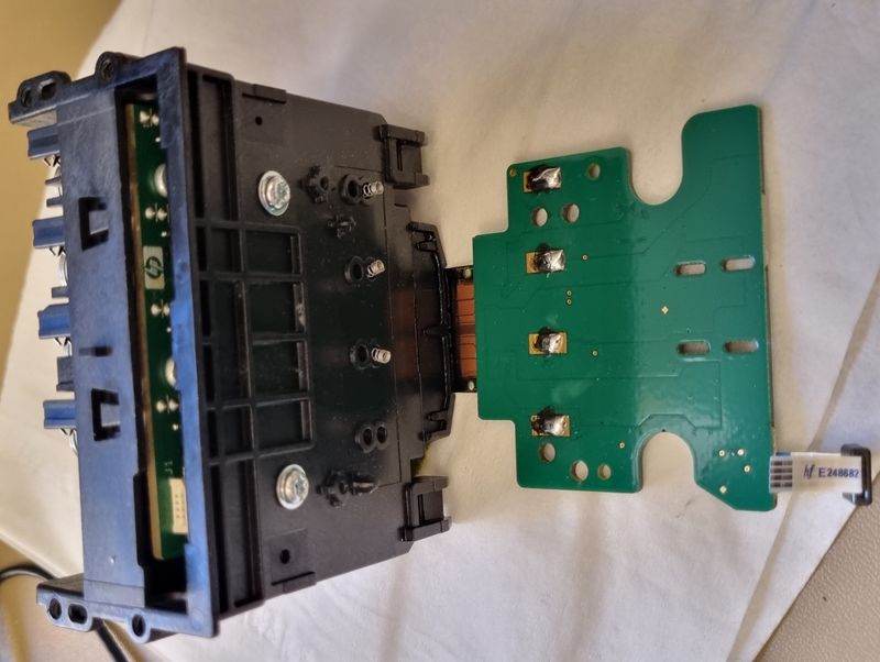

I tried this trick with the foil. It was not successful. What the video doesn't warn about is that the contact springs are not necessarily captive so when you take the back off, the springs can fly out and get lost, which is what happened to me. Without the springs to hold the foil against the contact pads, it is hit and miss as to whether the foil will make contact. In my case, it didn't. Instead, I resorted to using blobs of solder to connect the pads. This worked although, from the poor print quality, even after multiple head cleaning attempts, I think I'm going to have to change the printhead anyway 😞

I ended up buying a new printhead and that restored my 8620 to normal working condition. I thought of buying a new printer, which would have been a cheaper option, but I didn't find a current HP model that had the same features and none use the same cartridges so I opted to keep the 8620 and replace the printhead. It is currently using the HP setup cartridges that came with the printhead. I hope I don't have any issues when they run out and I go back to using compatible cartridges.
