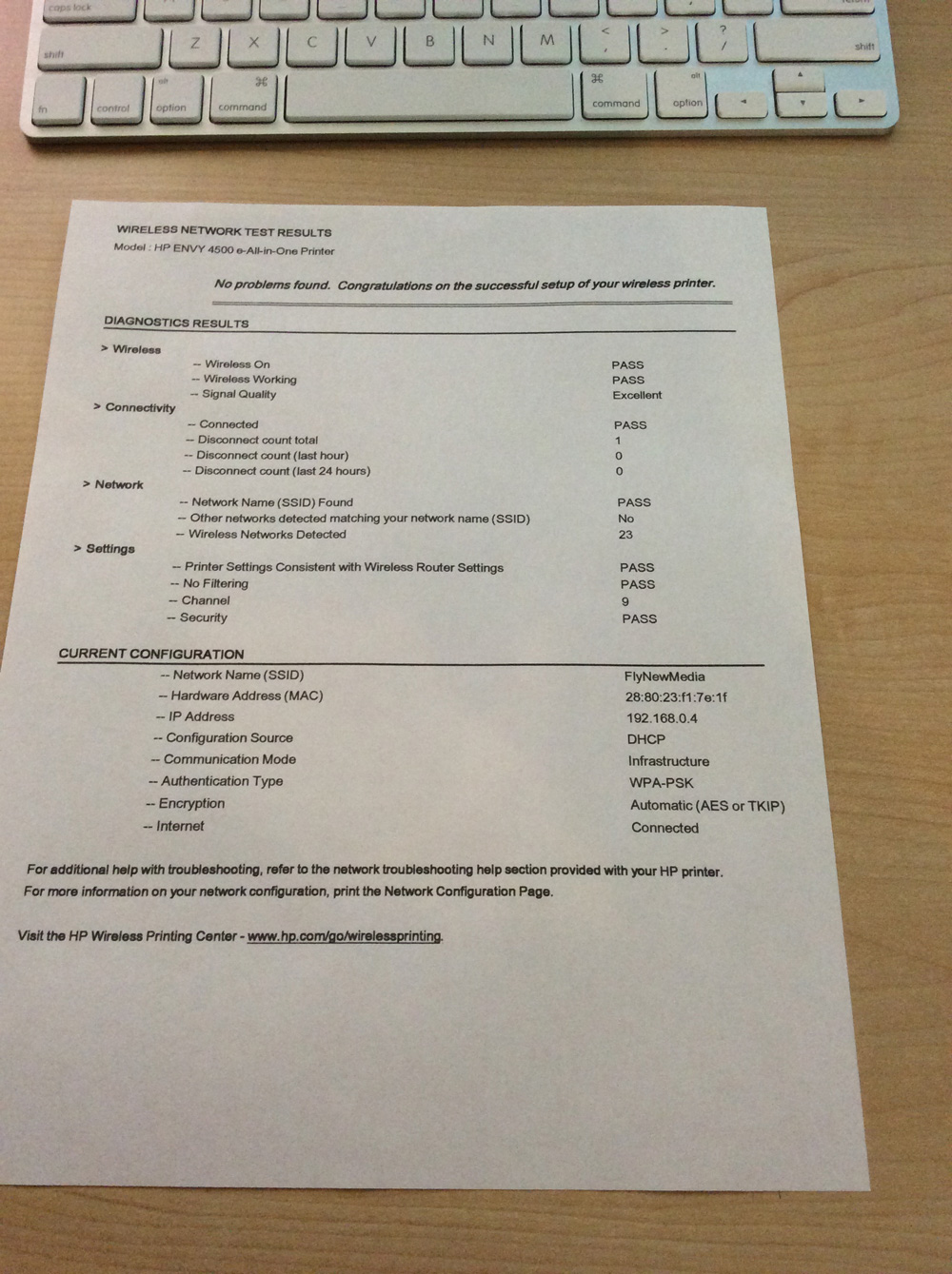

My ENVY 4500 Printer keeps disconnecting sporatically. One minute I can print just fine, the next the printer can't be reached. The printer status shows "The printer is not connected."
This keeps happening from all the devices, not just my iMAC. I tried from my PC Laptop, from my iPad, iPhone. Same story. When it goes off, it goes off for all devices. I tried reinstalling the printer, tried restarting it, unplugging it. Nothing seems to fix it.
If I print the report right from the printer durring this time, it says everything is connected and no problems found (see image attached).
Then after a while, like an hour or two later, all of a sudden the printer will spit out all the prints that were sitting in the queue.

I see that the printer has only disconnected from the network 1 time, thus I don't believe this is entirely a connection/communication issue. I do think it is a type of connection issue though. Let's try a simple potential fix first. One the front panel of the printer, please arrow down to and select Settings, then go to Wireless. In the wireless settings, please select Advanced Settings, then IPv6. Please choose Off in the IPv6 selection.
