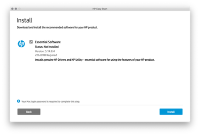

4. Once the uninstall completes.  Select Set Up New Device.
5. Go through the new device setup process by following the prompts.
6. This will lead to the software download/install prompt.
7. Select install and the remaining prompts to finish the process.

I ran into this same problem for the HP OfficeJet Pro x576 on the date the update came out, although it initially started out with a message that the "HPPreProcessing.filter will damage your computer". So I updated my software, but I got the same message, replacing the HpPreProcessing.filter with Matterhorn.filter. I then followed the very clear and easy instructions to Uninstall all HP software, and then re-installed a second time. It cleared it up immediately!
