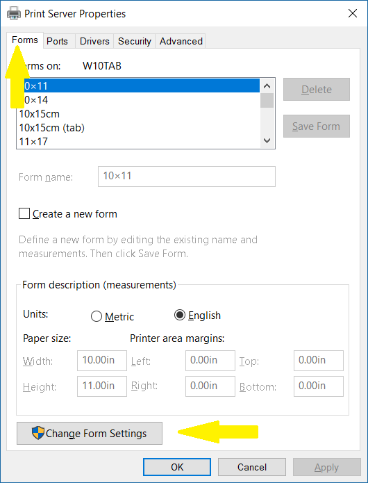

OK, I do not have an actual Envy 5530 to test but I did download and install the driver and get it to recognize 5.5x8.5 inch paper.  In Windows 10 do the following: go to the Control Panel, Devices and Printers.  Click once on the Envy 5530.  This will bring up some new commands at the top of the page, including "Print server properties".   Click on Print server properties.
When you click on the Print server properties it will bring up a box that will allow you to change forms.  Click the Forms tab at the top if it is not already selected, then click Change Form Settings at the bottom of the page.
This will open a new dialog box that looks a lot like the previous one.  Select the "Create a new form" box, type in a new name like 5.5x8.5in, make sure the dimensions are set to English, set the desired paper width and height, then Save Form.
The form will now appear in the list, click the Close button at the bottom.  Next double click on the HP Envy 5530, double click on Set Preferences, Paper/Quality, Advanced, Paper Size, select the new 5.5x8.5in paper size form you saved earlier, OK, Apply, OK.
All done!  Try out your new form size in your favorite program.  Have fun printing the invitations and please click the "thumbs up" and "Accept as solution" buttons when you have verified things work.  This will help others with similar issues find the solution.
