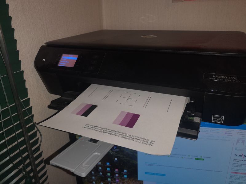

I have had this printer for awhile and it has been fairly reliable, but recently i cannot print at all without it jamming up. It seems like the paper is getting drawn in crooked or at least it ends up that way. I keep removing the jammed paper, but it just happens again. I even tried switching my printer paper to a different brand but it didn't help. I can't see anything wrong internally, though i have no idea what to look for since I'm not very tech savy. Any suggestions would be appreciated. I had not changed anything with the computer or printer prior to this issue so it just started out of the blue.
Issue is resolved. I cleaned the printer really good with a Q-tip, as recommended on a  youtube video. It cycled though a few more jammed pages, and it is working fine now. I've been able to print with no problem and it even sounds better.

Thanks for the response, but it didn't work, it's still jamming every time.
I had the same problem, colorcatrige was empty
Replace it and problem was solves
@blackrose66
You can remove the ink cartridge and place it back in or try changing ink cartridges. If that doesn't resolve the issue, it could be a possible hardware failure.
For the next course of action, I have sent you a private message, for more details that cannot be shared in a public post.
Thanks!
I am an HP Employee
