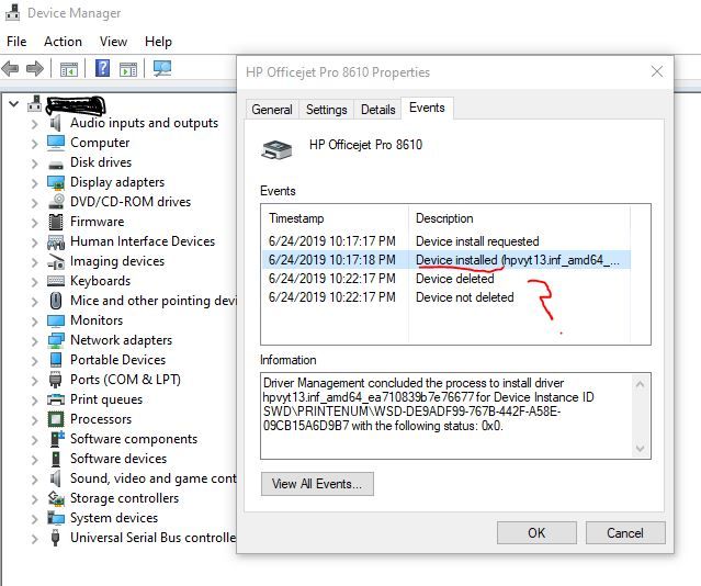

I will add that during the driver install, a printer entry briefly appears in the device manager. Then it disappears after the install fails. Below you can see the event log of the driver install. You can see that it initially installs the device driver, adds a device manager entry then 5 minutes later attempts to delete the device for no apparent reason. This is when the installer fails.
