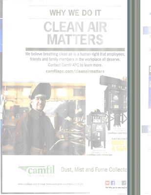

I am getting vertical lines every time I use the scanner on this OfficeJet Pro 7740.
I get the same lines whether I scan or copy, whether its in color or B&W, no matter what paper size the source or output is, and whether I use the top-feed or flatbed scanner.
Here is a scan of a blank sheet of paper:

03-22-2017 04:37 PM
Thanks for looking into it.
Below is a new scan, hopefully you can see it this time. The actual page is very faint, but the lines are clear as day.
They are multi-colored (like below) if I scan a colored page, and alternating B&W (looks like a barcode) if I scan in B&W.
03-23-2017 09:21 AM
Hey again!
Yes, this is definitely a hardware issue. Here is the link to contact support: HP Customer Support - Contact. Fill out and submit the form, and then choose the most convenient way to contact HP. I imagine this printer is still in warranty, as it didn't release until August 2016.
If it has always scanned/copied like this, it might be a ribbon connection issue. If it recently started doing this, then it's probably some sort of electrical component error.
Thanks for sending that photo! 🙂

03-23-2017 01:08 PM
Thanks all.
I just bought it from Office Depot last week, so I took it back and swapped it out for a new one. Works like a charm now.
Plus is was on sale for $50 less this week, so I got a refund besides
Thanks again!
