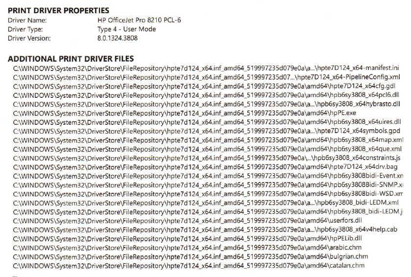

eurazmus,
Sorry.... In my haste to be brief, I was a bit too brief! What I actually meant to say was that after trying to print, the print jobs got stuck in the queue as in the past.
Let me provide you with an image of the print drivers found on the Windows Printer Test page for comparison to yours....
